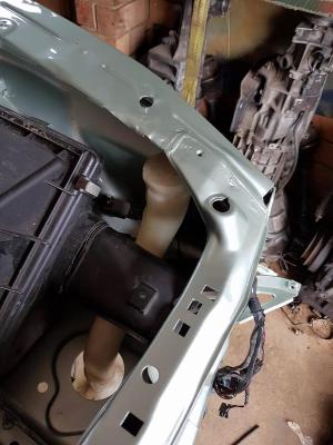

(Locky)'s Photo (Locky) 11 Mar 2017
fit easily suprisingly, dont have car with me atm so dont have good pics, kinda hard to explain but did it with a flat bar and a right angle brackeet. Just need to extend the wires and run the hose still
