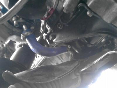

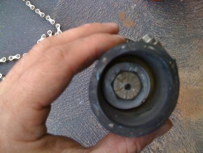

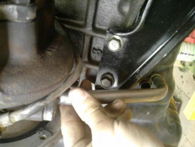

some pics of my install (its a ca remember but shouldnt be that different)
after manifold install had this issue
Attached Image: P280909_14_43_02.jpg
so done this
Attached Image: P170910_13_08_01.jpg
i run 19psi and it hasnt come off yet so just cut the oil drain like i did

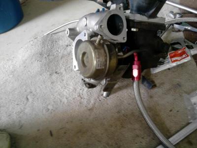

Attached Image: P170910_11_43_02.jpgAttached Image: P170910_13_08.jpg
Attached Image: P170910_13_09_02.jpg
now another problem i faced on the ca is woth the standard turbo the wastegate pressure line is on the turbo itself. i didnt want to drill and tap the s15 turbo so using the BOV provision on my intercooler plumbing i done this and it works a treat
