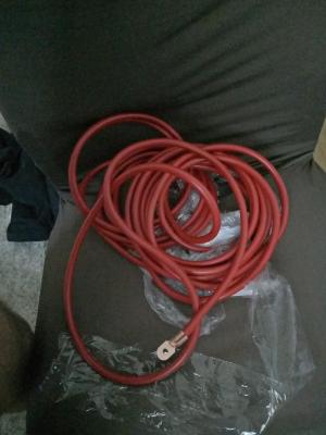

Parts required:
10m 3 AWG gauge cable (5.83mm diameter) (between 2 and 4 AWG is generally accepted as thick enough)
I cut this to 5m for both pos and gnd and was a perfect length.
~$80

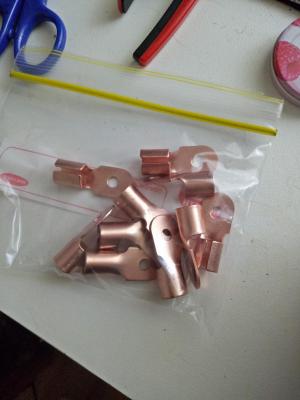

Crimp Terminal ends
~$8.95 for pack of 10
15mm diameter flex Plastic Corrugated Tube Electric Conduit
~$10
Total: $103.95
Other items you should also have in your garage if you are a self respectable enthusiast: Cable Ties, wire coat hanger to feed cable, electrical tape.

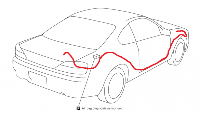

This is the general idea of the routing:
Attached Image: Untitled.png

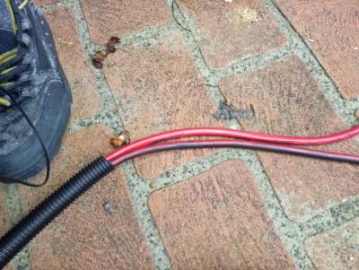

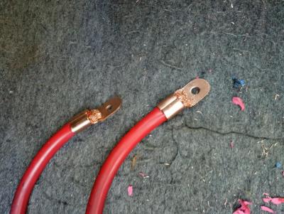

Generic terminals to suit 0-3 B&S gauge cable.
Attached Image: IMG20170106183953.jpg
Run the cable through the flexi tube to prevent any abrasion. I saved money by buying a single length of 10m cable, cutting it and spray painting one length black.

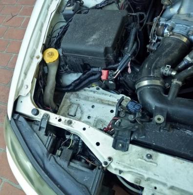

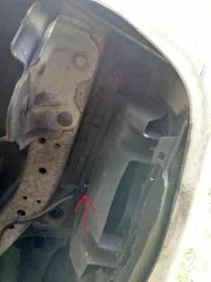

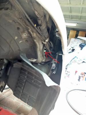

Remove the front right wheel and trim under the wheel arch.

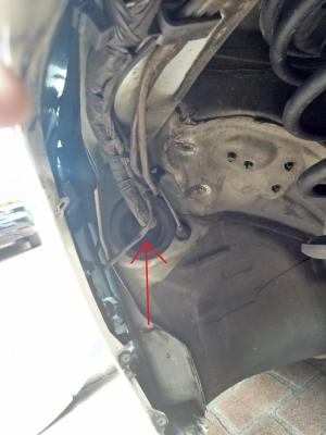

There is a port hole right next to the stock battery location where the windscreen washer reservoir is.
Attached Image: IMG20170107114358.jpg
The cable can run through here and over the top of the wheel arch. Use cable ties to secure it out of the way.

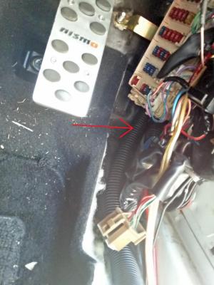

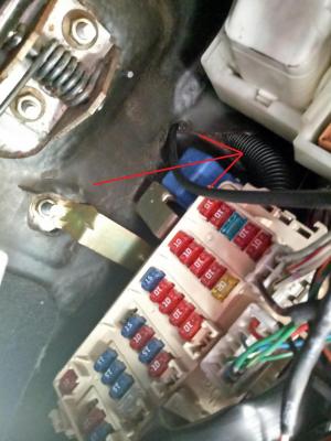

Remove the trim around the drivers side fuse box. There is one nut.
Once the cable enters the foot well it is routed behind the fuse box.
Attached Image: IMG20170107123142.jpg

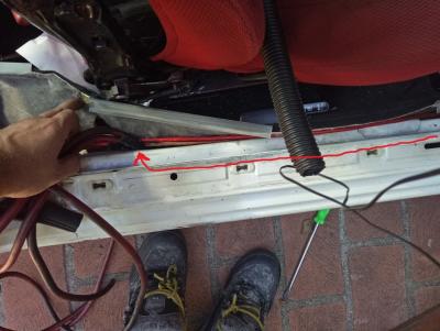

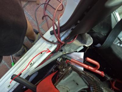

Now the cable runs along the under the carpet. The side skirting is clip in and can just be pulled off.
I routed the cable through a hole into the actual chassis siding skirt cavity to get around the hump where the boot/fuel cap lever is. The best way to do this is to feed coat hanger wire through taped to the cable.
Attached Image: IMG20170107151824.jpg
There is another hole along the side skirting where the cable can exit.
Attached Image: IMG20170107151842.jpg
Attached Image: IMG20170107151818.jpg

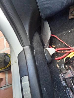

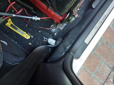

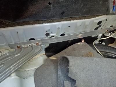

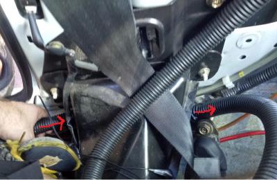

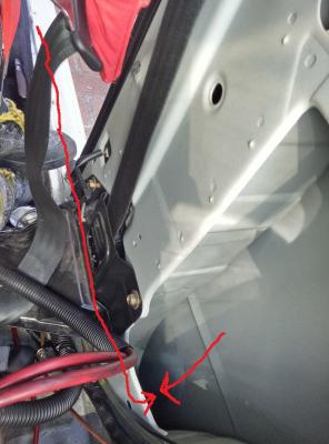

Remove the rear seats and side trim on the right side.
Attached Image: IMG20170107153526.jpg
Note where the cable exits the side skirting the carpet is a bit stretched to fit over the tubing.
Attached Image: IMG20170107164815.jpg
Attached Image: IMG20170107183654.jpg
Then the cable goes behind the bracket in the above photo
Attached Image: IMG20170107153704.jpg

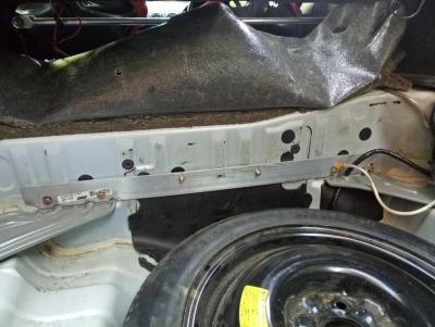

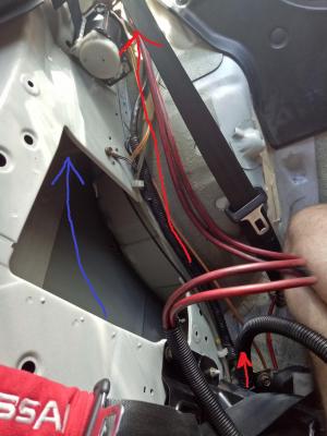

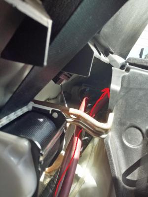

Note the cable could also exit through the above gap rather than the chassis rail as previously shown. It could also continue running through here to the boot - see blue arrow in the below picture.
Attached Image: IMG20170107153534.jpg

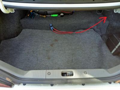

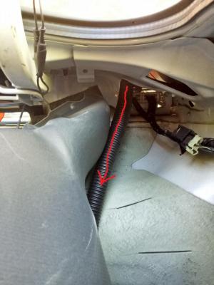

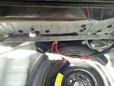

The below photo shows the final routing into the boot.
Attached Image: IMG20170107153604.jpg

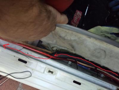

Below shows the routing behind the trim, viewed from the boot.
Attached Image: IMG20170107160700.jpg
Attached Image: IMG20170107162225.jpg
I crimped the ends of the terminals with the help of a mallet and a block of wood.

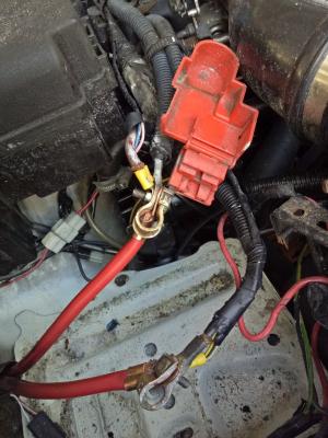

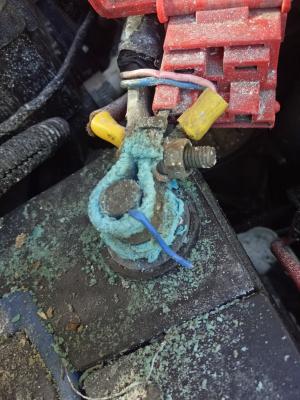

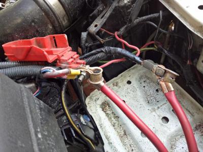

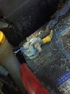

The factory terminals were incredibly corroded. I took to them with a dremel with a wire brush bit.
Attached Image: IMG20170114164404.jpg
Attached Image: IMG20170114164414.jpg
After cleaning them up they can be bolted in.
Attached Image: IMG20170114182429.jpg
Attached Image: IMG20170114182437.jpg
Use heat shrink with electrical tape to insulate the connection. If you dont ever want to go back to the stock location then deleting the factory terminals and installing a terminal block will be the way to go. Either way ensuring proper insulation is essential.

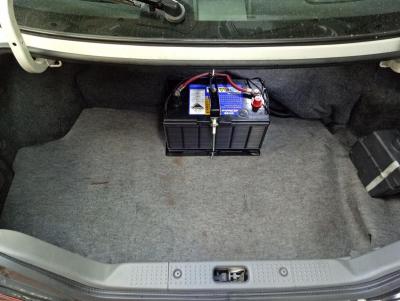

The Battery Install

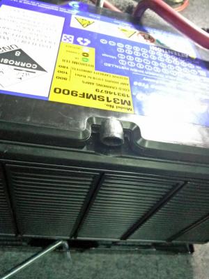

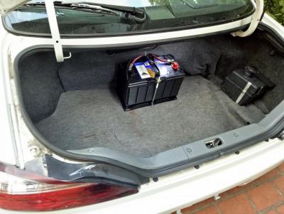

I put the battery in the centre with no box. I didn't really want to second guess what I may or may not get defected for. My battery does have a vent hole which I will route to atmosphere.

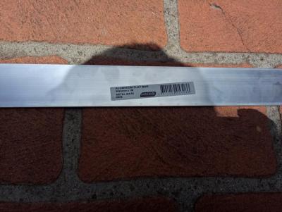

1mx3mmx50mm Aluminum bar from bunnings
~$15

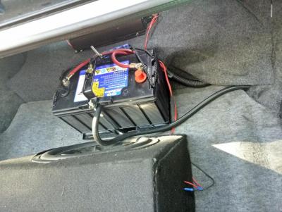

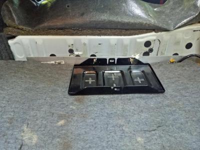

Battery Tray
~$35
Angle grinder

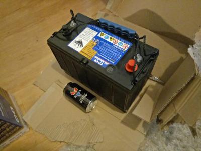

I opted for this AC Delco with a beefy 900 CCA for $197. If you have auxiliary electronics you don't need to blow $400 on a brand name. AC Delco are also an official OEM part manufacturer so you know there is quality testing behind their products.
Attached Image: IMG20170110193711.jpg

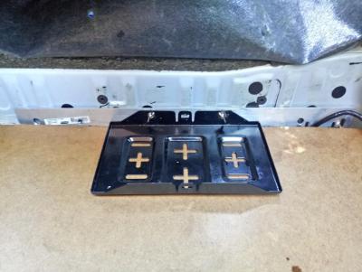

The 3mm aluminium bar required some cutting and shaping to fit the chassis bracket where it will bolt up. The 4 stock bolts are not long enough which is why you need tp replace them with the 35mm ones. They are M8 size/threading.
Attached Image: IMG20170114130729.jpg
Attached Image: IMG20170114140323.jpg
Attached Image: IMG20170114155936.jpg
Attached Image: IMG20170114163602.jpg
With the bar done now the battery tray can be bolted to it. This is what the short 15mm M8 bolts are for, though they dont have to be this size, use a wing nut so the tray can be removed if you need to access the spare tire.
Attached Image: IMG20170114161836.jpg
Attached Image: IMG20170114162143.jpg
Attached Image: IMG20170114163912.jpg

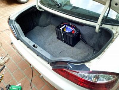

Now put all the trim back, bolt up the terminals and youre done !
Attached Image: IMG20170114184451.jpg
Attached Image: IMG20170114184500.jpg
Attached Image: IMG20170114184513.jpg
Looks pretty neat, though the bracketing could be made a bit more sturdier with angle brackets and what not if you wanted to.

#2 pmod
  • Joined:13-May 10
  • Car:Fruity 180sx
Posted 09 January 2017 - 07:57 AM
Nice work. As a suggestion to improve your setup, replace the bolt and nut on the factory terminals, then clamp the bolt down using a nut to turn the bolt into a stud. You can then shim the seating surface for the ring terminal using washers [to clear whatever is around], and bolt an un-shaved ring terminal in place. The less copper that's removed from the terminal, the less likely it is to distort and tear when the cable is moved.
You can then cover the entire oem battery terminal with a couple of layers of 50mm heatshrink tubing (double-wall with glue), pressing the overhang either side whilst hot for a watertight seal. Tuck the oem terminals to the side and zip-tie them in place, or cut some slots into two tiny plstic jiffy boxes from Jaycar, and bolt the boxes in place, so as to remove absolutely any chance of a short. With the jiffy boxes you don't really have to heatshrink the cable.

#5 matth23
  • Joined:01-February 12
Posted 14 January 2017 - 07:38 PM
Yeah, thats definetly a better way I re did the front terminals after i realised i didnt need to grind them. I will probably add a fuse near the battery too.
