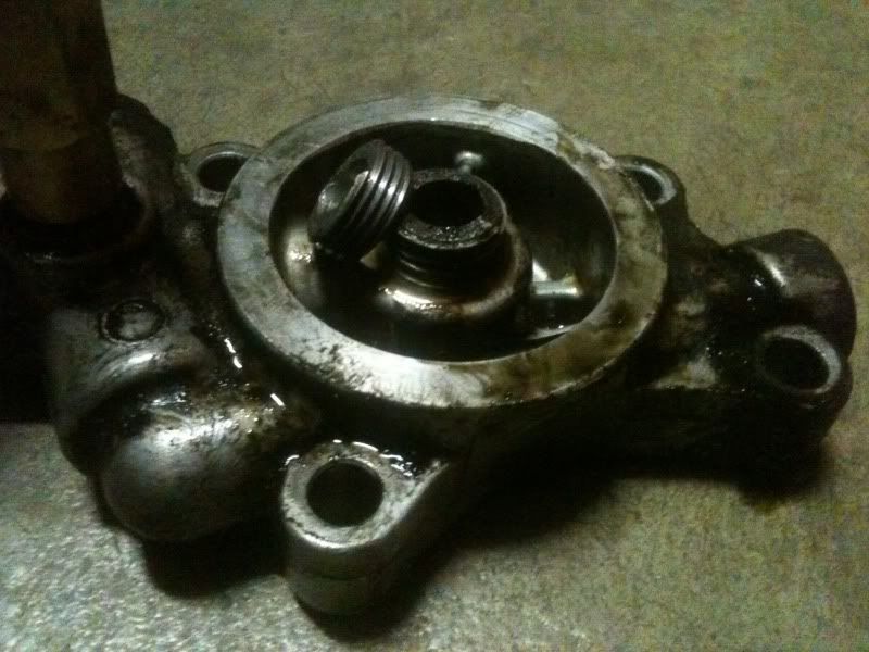

So long story short this happened....
It's the plate that bolts onto the block that the oil filter screws onto. Anyone have a spare they are willing to part with? Need it pretty desperately.

Seen this happen so many times people using oil coolers that come with a sandwich plate, am I correct in assuming this is the cause?
When buying oil filter relocation kits get one that comes with adapter plate not sandwich plate

Its due to not backing off the thread each oil change, every time you put a new filter on you're tighting the thread more and more... very over looked problem. But best not to use sandwich plates.

Gfunk is right on the money, over tigtened the adapter nut and snapped the original thread. All is well now tho, i managed to source one :thumb:

Haha, same thing happened to me but the thread stayed inside the oil filter. Oops.
