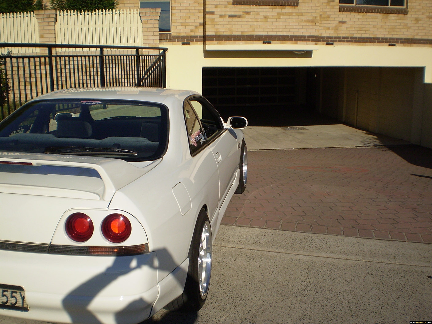

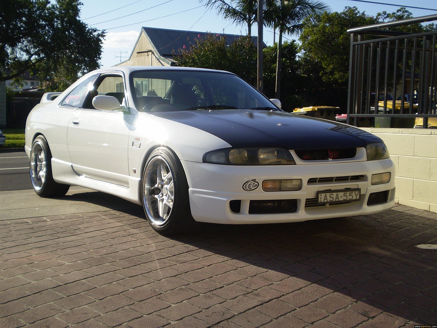

also, here are two pics of a car with 10 inch wide wheels with a +22 offset.. you should be able to work it out from there..
what kind of 15's are you gonna be putting on an r33? you best be dropping it absolutely on its guts or its gonna look weird imo..
