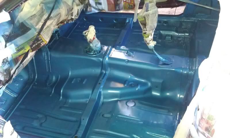

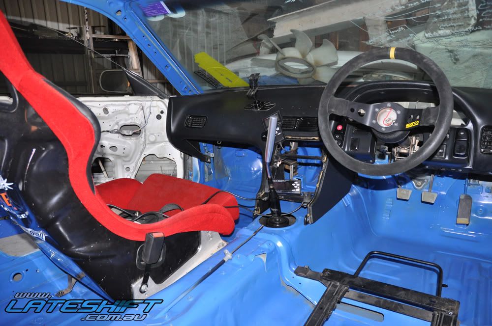

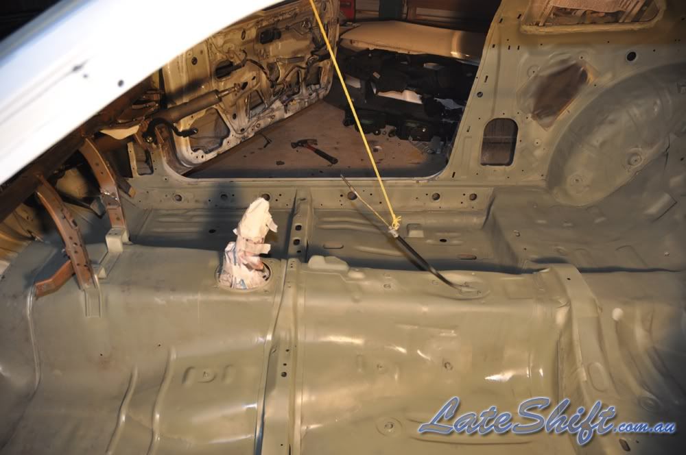

I used Rustkill spray cans from Mitre 10 last year. After seeing Nigels 180sx results, seemed like it was worth a try. Turned out awesome. 1 coat of primer first and 4 coats of blue and tuned out like this. Still gotta put down a clear coat though.
2nd or 3rd coat below. Cant remember.
Primer
Edited by SIL-514, 19 January 2012 - 07:43 PM.
