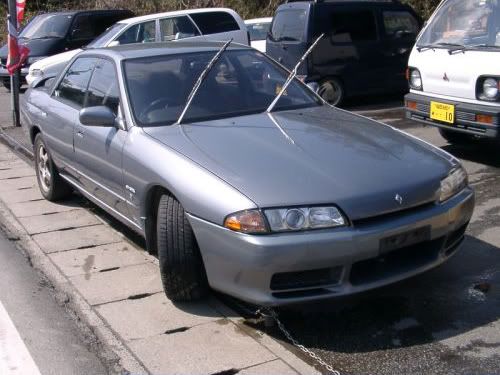

WHEN I GOT IT
IN JAPAN:

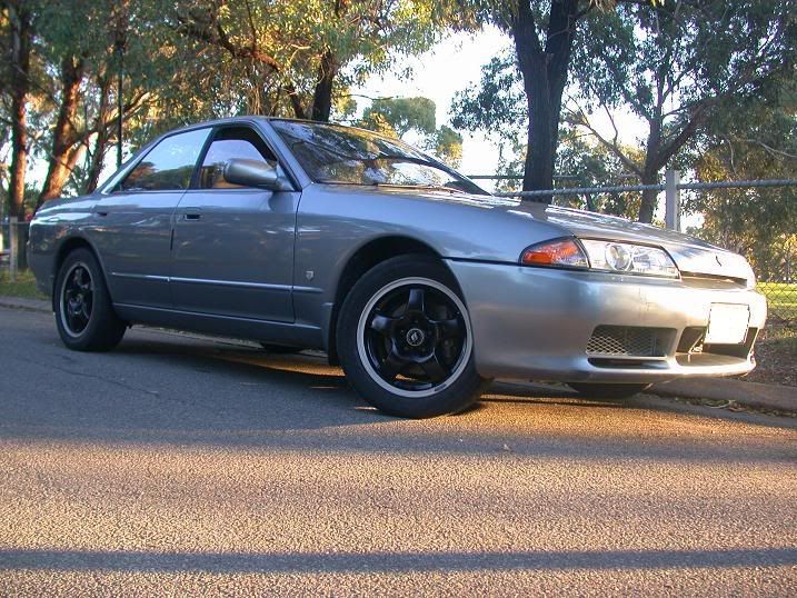

NEW PICS
Spoiler taken off:
New Exhuast on:

like i told you before dude, you should have gone with lam and saved yourself some cash but either way its on the road now right.
and your muffler is hanging pretty low, so just watch yourself when you lower it, i hated hitting my muffler on things, the sound of it hitting something made me feel sick, haha.

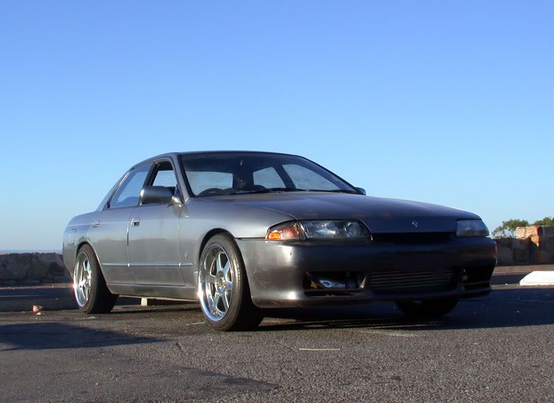

updated rims:

yes, i know, i need new suspension. althou there are benefits to driving a monster truck.
