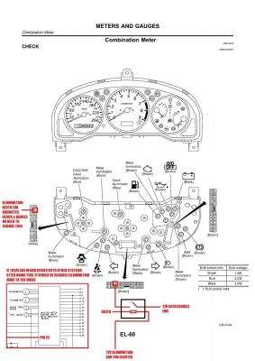

View PostSuspop, on 18 April 2012 - 10:42 PM, said:
I'm considering installing a circuit that will forcefully amp up the power hence light.
Sus - what about simply running a relay linked to accessories or a direct (fused) line from the battery? Assuming your bulbs are new 3w units and all the contacts are clean, the issue is likely to be too much resitance on the lillumination line. You shouldn't have to hook up a transformer and raise voltage above 12v.
Install a 12v power recifier prior to the relay to should you experience fluctuations in the light output due to the alternator.
Pic to avoid dodgy explanations. Bear in mind I haven't had to try this with my cluster, but my main loom is S13 anyway:

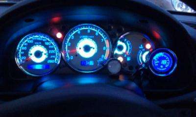

Attached Image: photo.JPG
These are the EL Dials (sorry for the poor quality - only one I have on my phone...). Easy to install. Didn't take very long at all. Hardest part is getting the cluster out but beyond that it takes no effort.
The AUS models I have NO IDEA where to purchase. They used to be sold when the S15 first came out but no one stocks them anymore. A set came with my car that I never installed and sold. Then I saw them installed and realized how great they were and then spent the next 6 months trolling ebay and looking everywhere for them. I finally found a set. There's one more ADM model on eBay there if anyone wants to look it up. The guy reposts it for sale every other week as no buyer yet.
If you have a JDM cluster (which you do) then just go on yahoo japan auctions and get streeter to organize shipping it to you :).

Orange dials.
Attached Image: Icons.jpg
I had those EL dials on my 180 a long time ago. They look cool, but the center circles are stupidly bright. No idea wtf they were thinking when they made them that way.
Best mod would be to sever contact and turn that piece off.
They do however come with a dimming module, for those of you who like adjustability.
Attached Image: s15 cluster-001.jpg
Yes option2, I kind of have too many acc wires. Getting messy...
As if so many complaints of shit LED spread and they haven't made a one that's got factory spread but just brighter.
No fancy colors or finishes, just normal - but brighter. Such a common problem.
